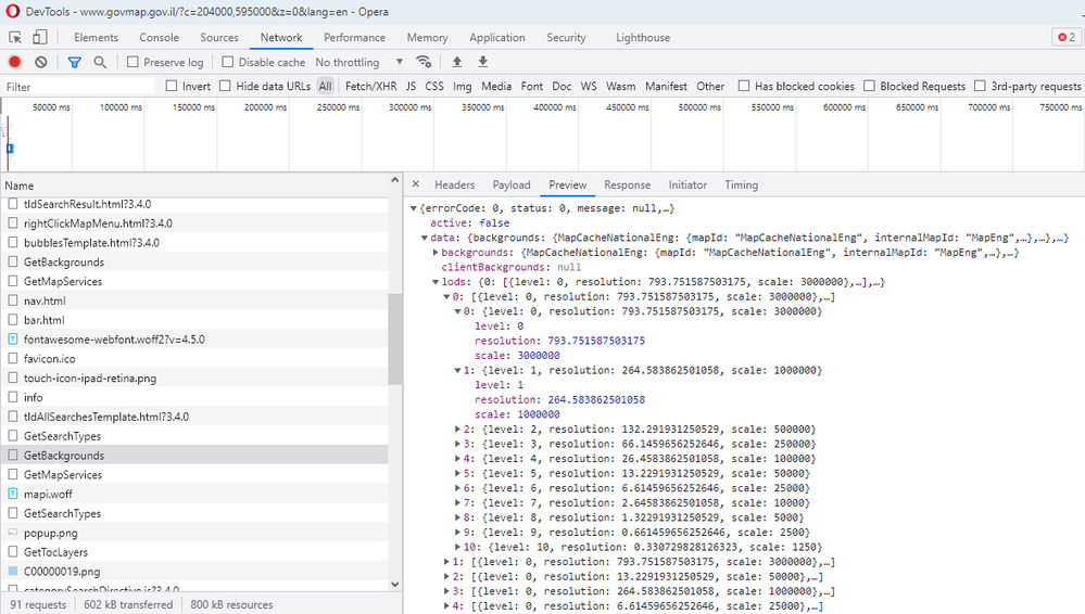

Yes, you can determine the tile scheme by poking around a bit in the application's source code using your browser's developer tools.  For example, the tiling info can be seen by doing a search for tileInfo in the esriMap.js file, as shown below:
As for the lods (levels of detail), it appears you can find information for those in the request to GetBackgrounds:
