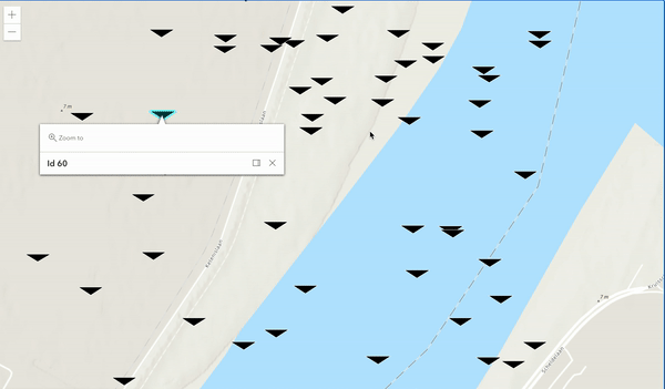

I'm using the view hitTest function to determine which feature is selected. But it seems like there are some issues with the hitTest for a dynamic updating layer.
Reproduce steps:
- A FeatureLayer displaying 40 graphics. Each 100ms a mocked update will be processed by ApplyEdits.
- HitTest function with hitResults[ => The first result will be used for the content and location of the popup.
Why we're using hitTest:
We're creating a custom web element for displaying a popup instead of displaying the default popupTemplate. (should be created each time an asset changes)
=> A wrong popup is displayed when clicking a feature/graphic.

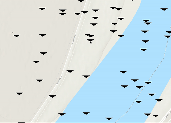

When applying your changes in a codepen, I still see the same issues.
Seems like the results of the hitTest function returns the wrong feature. (Because the layer is updating at the same time)
New issue (selected feature)
