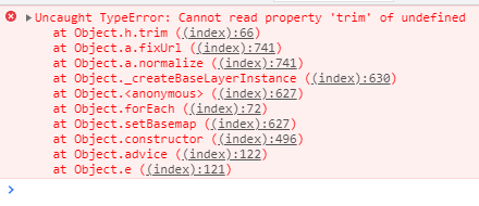

And this throws the following error:
Any suggestions?

RichardMoussopo
var map;
require([
'esri/basemaps',
'esri/map',
'esri/layers/WebTiledLayer',
'esri/dijit/BasemapLayer',
'esri/dijit/Basemap',
'esri/layers/ArcGISTiledMapServiceLayer',
'dojo/dom',
'dojo/domReady!',
], function (
esriBasemaps,
Map,
WebTiledLayer,
BasemapLayer,
Basemap,
ArcGISTiledMapServiceLayer,
dom
var nearmapTiledLayer = new WebTiledLayer(
'https://api.nearmap.com/tiles/v3/Vert/{z}/{x}/{y}.jpg?apikey=MY_NEARMAP_API_KEY',
copyright: 'Nearmap',
var nearmapBasemapLayer = new BasemapLayer({
type: 'WebTiledLayer',
url:
//subDomains: ['0', '1', '2', '3'],
var nearmapBasemap = new Basemap({
layers: [nearmapBasemapLayer],
title: 'Nearmap',
esriBasemaps.nearmap = {
baseMapLayers: [nearmapBasemap],
thumbnailUrl: '',
title: 'Nearmap',
map = new Map('mapDiv', {
center: [-83.070543, 39.86905],
basemap: 'nearmap',
zoom: 14,
//map.addLayer(nearmapTiledLayer);
