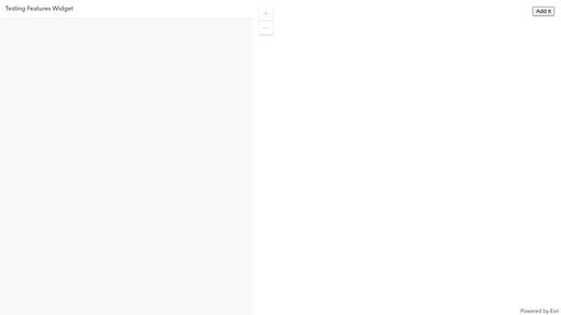

So, to display all attributes of a fL in a popup I wrote this script (see below) to get all the fields of the feature layer and set the popuptemplate with those fields. It works but the format of the display is not satisfactory. See this codepen link and click on a feature to see the popup display. I'd love to get the table style format to display the results. Any ideas?
