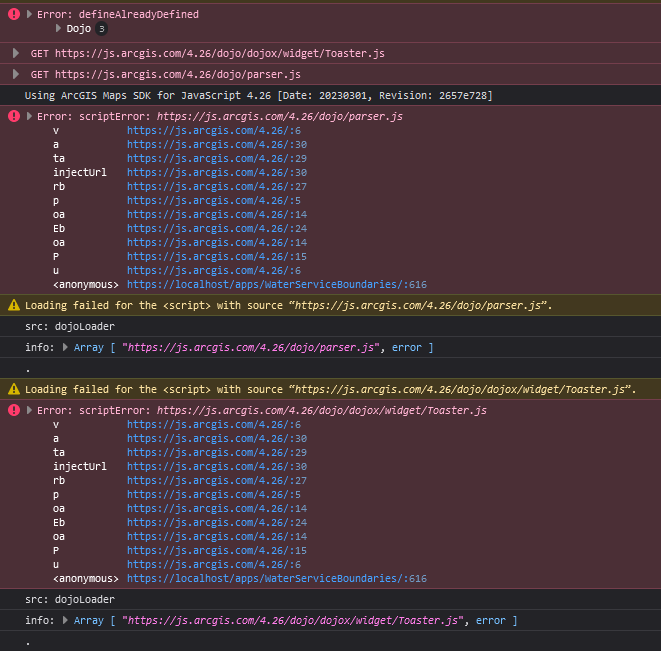

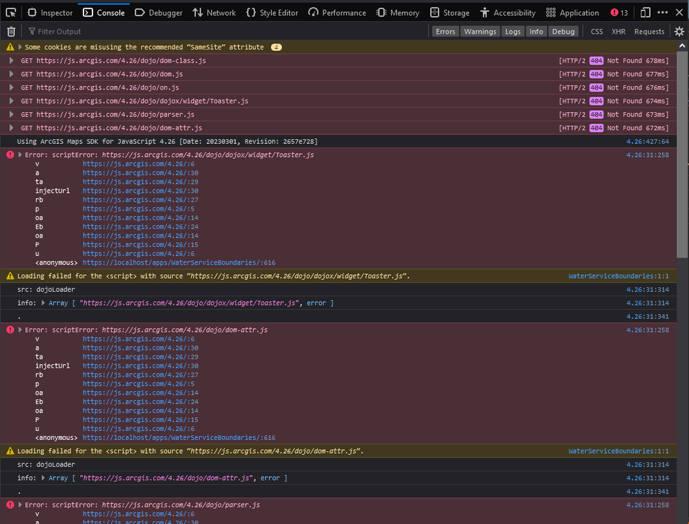

Currently, I am developing a web GIS app in a .Net C# project using ArcGIS Maps SDK for JavaScript 4.24. I am interested in trying out the new "highlightIds" feature for the FeatureTable, which was introduced in ArcGIS Maps SDK for JavaScript 4.25. However, when I attempted to replace the relevant code in the source code (replace <link rel="stylesheet" href="https://js.arcgis.com/4.24/esri/themes/light/main.css" /> <script src="https://js.arcgis.com/4.24/"></script> with <link rel="stylesheet" href="https://js.arcgis.com/4.26/esri/themes/light/main.css" /> <script src="https://js.arcgis.com/4.26/"></script>), the app failed to load and returned errors (as shown in the attached image) indicating that certain online resources could not be found (404 Not Found Error). For example, while "https://js.arcgis.com/4.24/dojo/dojo.js" loaded without issue, "https://js.arcgis.com/4.26/dojo/dojo.js" was not found.

I read from this https://developers.arcgis.com/javascript/latest/4.25/ that the CDN on js.arcgis.com will no longer host the following AMD packages for version 4.25 and later, and hence dojo.js not found is expected.
I guess options now will be to either host it or reference it from one of the hosting CDN as suggested on dojo page: Download - Dojo Toolkit

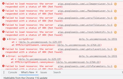

I am getting these errors
