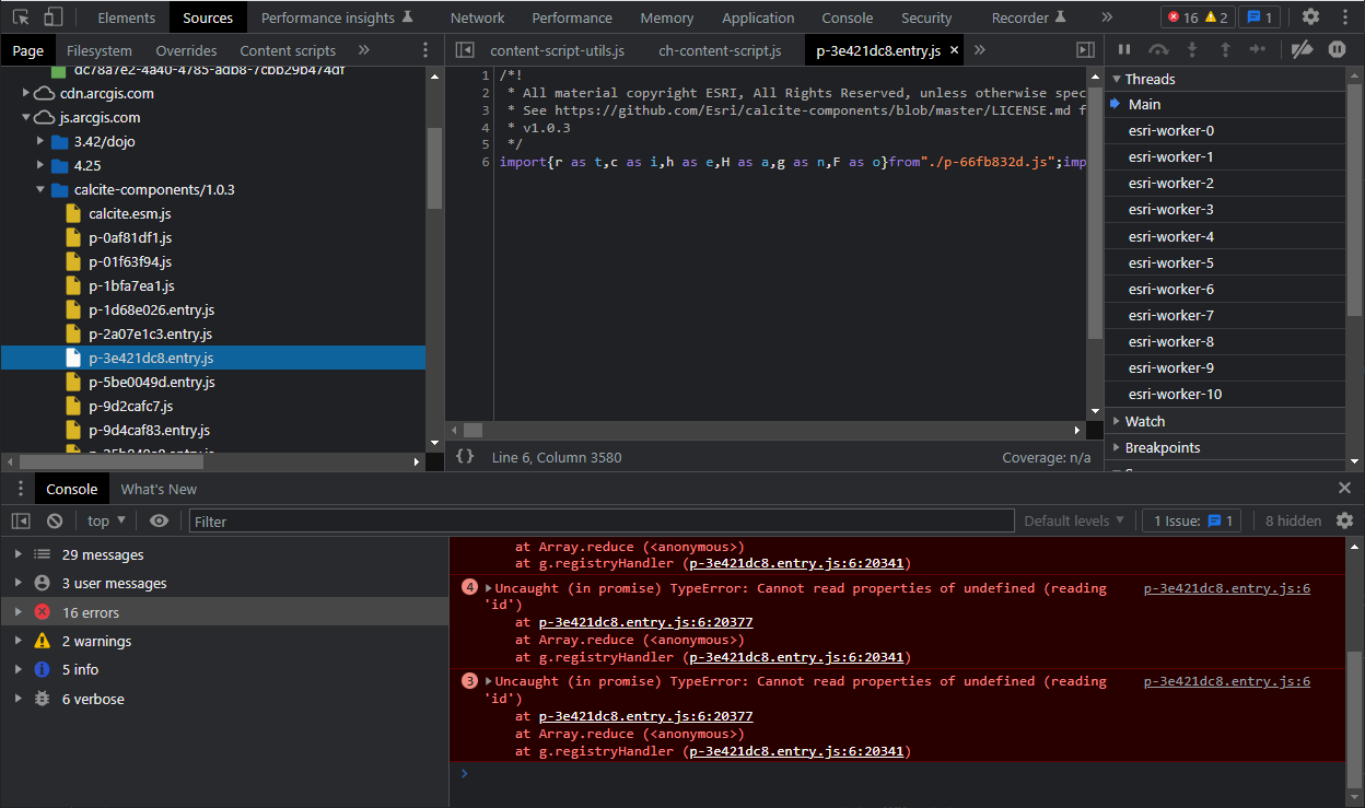

Simultaneous upgrade from JS 4.24 and Calcite1.0.0-beta.97 now sends an error to the console when loading the JSAPI:
caught TypeError: Cannot read properties of undefined (reading 'style') at ResizeObserver.<anonymous> (p-3e421dc8.entry.js:6:3580)
The stack does not return any references to any of my code. There's a ResizeObserver API, but it's not clear how this relates to the JSAPI other than Calcite contains the script 3e421dc8.entry.js
Anyone else seeing this or have a fix?

Looks like this is an issue with calcite, and not the Maps SDK. According to this issue, the fix is available in 1.0.4-next.4 release.
https://github.com/Esri/calcite-components/issues/6310
So you can try the calcite "next" build for now until the next production release.

4.25 was built using 1.0.0-beta.97, lots of changes to version 1.0.3. Are there particular widgets you are using that cause this error? The "next" version of the API uses calcite-components 1.0.3, can you try that and see if the error persists?
https://www.npmjs.com/package/@arcgis/core/v/4.26.0-next.20230205?activeTab=explore

Are there particular widgets you are using that cause this error? I have identifed the HTML that causes the error:
    <calcite-card id="tool-container">
        <calcite-tabs>
            <calcite-tab-nav slot="title-group">
                <calcite-tab-title selected>Navigation</calcite-tab-title>
                <calcite-tab-title>Appearance</calcite-tab-title>
            </calcite-tab-nav>
            <calcite-tab selected>
                <div id="navigation-container"></div>
            </calcite-tab>
            <calcite-tab>
                <div id="appearance-container"></div>
            </calcite-tab>
        </calcite-tabs>
    </calcite-card>
in particular the declaration:
I'm still trying to figure out what's up with calcite-tab-nav.
can you try that and see if the error persists? The error persists at 4.26.

Yep, Calcite. We're not ready for 1.0.4-next.4.
