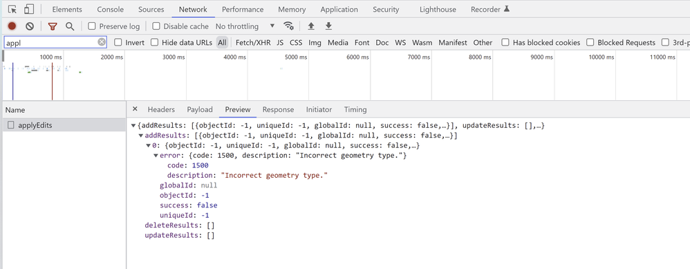

JillianStanford
Hi,
When you click the "Update Incidents" button, what is the response from the applyEdits request?
Here is an example of a failed request. In this case the error description is pretty helpful. Although, it sounds like applyEdits is succeeding, if the point is being added to the layer.
Can you also check the request parameters to confirm that all of the user submitted attributes are making it into the payload?
