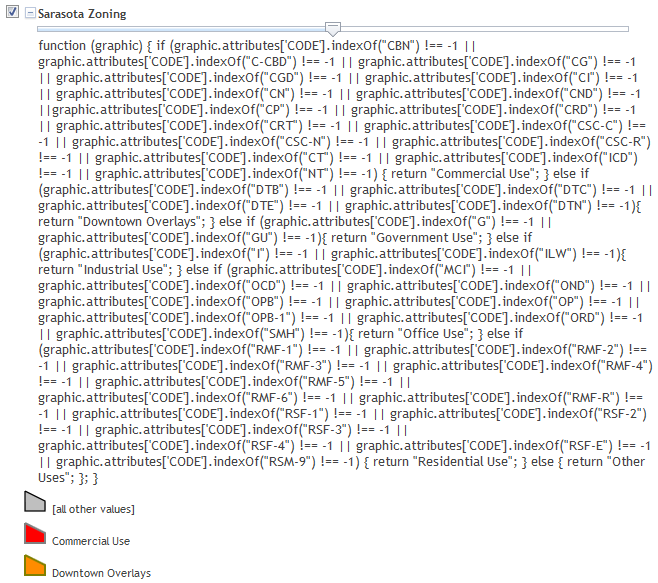

Hi all-
So I'm trying to render groups of values based on the blog at:
Data Visualization with ArcGIS API for JavaScript: Show Data by Unique Value | ArcGIS Blog
The problem is that while the renderer portion works great, I can't seem to get around the fact that the TOC wants to list the "if else if" statement text within Nianwei Liu's table of contents.  Here is some code of what I've done so far, I just can't seem to around the fact that the TOC wants to list the attribute field values on which I am rendering, but is listing the function text instead:
var defSym = new SimpleFillSymbol().setStyle(SimpleFillSymbol.STYLE_SOLID);
  defSym.outline.setStyle(SimpleLineSymbol.STYLE_SOLID);
var cszRenderer = new UniqueValueRenderer(defSym, function(graphic) {
if (graphic.attributes['CODE'].indexOf("DTB") !== -1 || graphic.attributes['CODE'].indexOf("DTC") !== -1 ||
          graphic.attributes['CODE'].indexOf("DTE") !== -1 || graphic.attributes['CODE'].indexOf("DTN") !== -1){
          return "Downtown Overlays";
} else if (graphic.attributes['CODE'].indexOf("G") !== -1 || graphic.attributes['CODE'].indexOf("GU") !== -1){
          return "Government Use";
} else {
         return "Other Uses";
var dtSym = new SimpleFillSymbol(SimpleFillSymbol.STYLE_SOLID, new SimpleLineSymbol(SimpleLineSymbol.STYLE_SOLID, new Color("#808000"), 2),new Color("#FF8C00"));
        cszRenderer.addValue("Downtown Overlays", dtSym);
  var gSym = new SimpleFillSymbol(SimpleFillSymbol.STYLE_SOLID, new SimpleLineSymbol(SimpleLineSymbol.STYLE_SOLID, new Color("#808080"), 2),new Color("#A4F9FE"));
        cszRenderer.addValue("Government Use", gSym);
lyrCsZoning.setRenderer(cszRenderer);
Result:
Any help is appreciated.  If I can just somehow reverse how the renderer is set up so I can return the attribute and not the function.  Some sort of nested function I think would work but I just can't see it--
Thanks-
David

I was able to get rid of that text with a small modification to the TOC.js. This is a local copy I have of the current TOC
I commented out line 238
anode.innerHTML = af;
which is part of this larger section
if (r.infos) {
  //UniqueValueRenderer |ClassBreaksRenderer
  var legs = r.infos;
  if (r.defaultSymbol && legs.length > 0 && legs[0].label != '[all other values]') {
    // insert at top
    legs.unshift({
      label: '[all other values]',
      symbol: r.defaultSymbol
  var af = r.attributeField + (r.normalizationField ? '/' + r.normalizationField : '');
  af += (r.attributeField2 ? '/' + r.attributeField2 : '') + (r.attributeField3 ? '/' + r.attributeField3 : '');
  var anode = domConstruct.create('div', {}, this.containerNode);
  domStyle.set(anode, 'paddingLeft', '' + this.rootLayerTOC.tocWidget.indentSize * (this.rootLayerTOC._currentIndent + 2) + 'px');
  //anode.innerHTML = af;
  this._createChildrenNodes(legs, 'legend');
} else {
  //this._createChildrenNodes([rootLayer.renderer], 'legend');
  this._setIconNode(rootLayer.renderer, this.iconNode, this);
  domConstruct.destroy(this.containerNode);
  this.containerNode = null;
It turns out that r.attributeField is where the function text is held.
I haven't tested it on other situations (renderers or not), so I don't know what that larger implications of that will be.

Way to go Ken, that did it.  Clearly I need to spend more time with the TOC widget, but I see it now: this is where Nianwei Liu‌ is placing the attributeField name of the attribute to be listed when rendering unique values.  I would only caution users that by commenting out the attributeField option, no layers in the TOC will displace a header.  Thanks again for your help!
NianweiLiu
I put in a string type check for the second parameter of the renderere constructor in the latest check in. That shold take care of the problem.
DavidColey
MVP Frequent Contributor
Thank you Nianwei - I incorporated the changes, works like a charm.  attribubeField is displayed where the UNR is utilitizing a string, and not where the UNR is utilizing a function.  Thank you for your all of your work on this widget over the years - it is quite an elegant solution.  Robert Robert Scheitlin, GISP, thanks to you as well--
