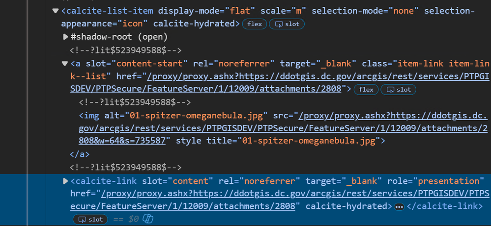

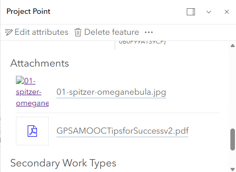

Image attachments are not showing in popup from a secured service. but clicking the link opens the image in a different tab.
If the additional parameters w&s are removed from img src, the image is visible.

I have an asp .NET core proxy to handle secured services, and it works fine.  The proxy configuration has credentials. The problem happens on the widget too.
 "allowedReferrers": [ "*" ],
 "tokenCacheMinutes": 59,
 "serverUrls": [
     "url": "https://maps2.dcgis.dc.gov/dcgis/",
     "username": "ccccc",
     "password": "ccccc",
     "tokenUrl": "https://maps2.dcgis.dc.gov/dcgis/tokens/generateToken",
     "referer": "requestip",
     "useAppPoolIdentity": false

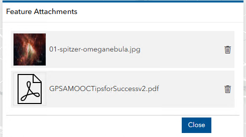

I useFeatureLayer.queryAttachments to show on a form the attachments with no problem.
In popup it looks like this
The only difference I see is that in the popup the image comes with additional parameters
Appreciate any help on this.
MKY
Is it possible to add a property to AttachmentQuery to control (disable) dynamic image resizing and scaling?
When using proxy and the w and s parameters prevent it from showing in the popup.
