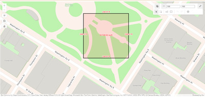

Hello Everyone,
I am trying to add a polygon graphic on the map . But the catch is i am trying to take user's input for its dimensions and then when i click on the map ,my code will calculate all the vertices and plot it on the map. The problem is, suppose i am taking user's input as 100 feet as length and 100 feet as breadth . When the polygon gets drawn, the actual area and dimensions are different then what i want.
My map's spatial reference is WGS85 and wkid is 102100.
This is my code which i am using for calculating the vertices:

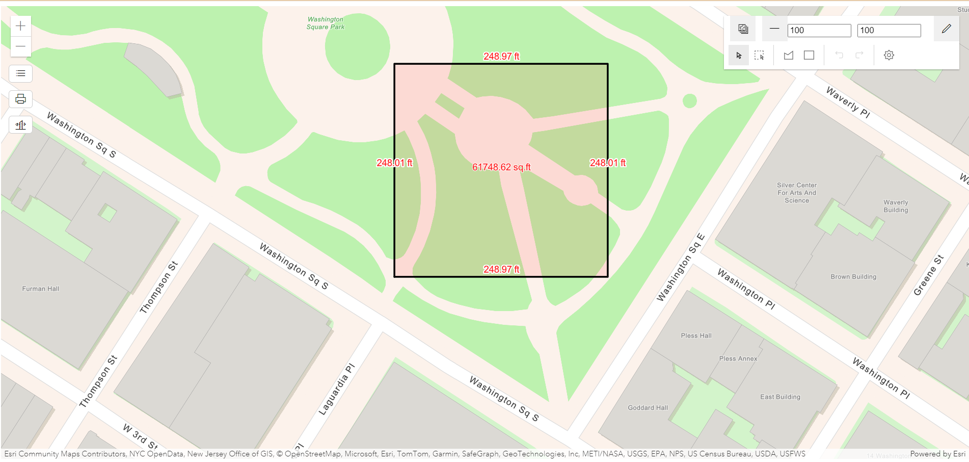

i am also attaching some screenshots for better understanding .
As you guys can see took input 100feet as length and 100 feet as breadth but when polygon is drawn i am getting different. Can you please tell me what i am doing wrong here . ?
JoelBennett
MVP Regular Contributor
One of the main problems is that your measurements are in feet, but the coordinate system units for Web Mercator are meters.  Even then, one might expect 100 meters to be 328.084 feet, but that's not what the screenshot shows either.
