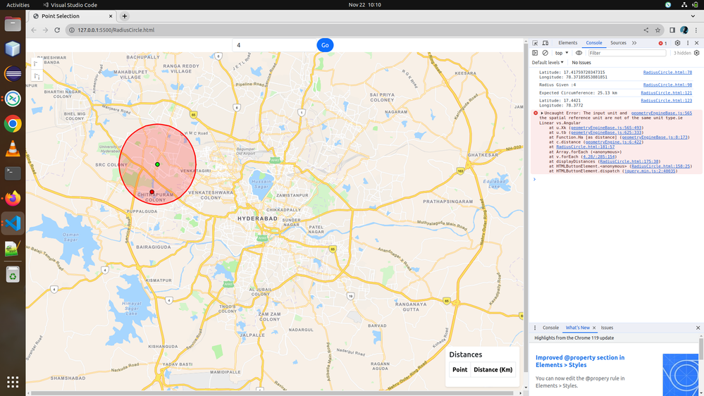

Hello ,
i am doing a requirement , i.e in arcgis/navigation map i have the text field that enters the radius and go button for generating the circle as per the given radius.
here green point is my center point , red is selected point(should be one or many number of points).
so firstly i will select some points on the map and i will enter the radius , click on Go , so when i click on Go button the circle should formed according to radius & should display the  distance of the selected points to the center point in the table.
the circle is forming but i am facing the issue of distance between the selected points to center point was not calculating & repeatedly throwing the errors ,how can i solve this errors and display the distance.
Error is Exactly at this line
const distance = geometryEngine.distance(centerGeom, point, "kilometers");
Screenshot from 2023-11-22 10-10-20.pngScreenshot from 2023-11-22 10-10-20.png
this is my code, and please refer my attachments for the errors

7 Replies
JoelBennett
MVP Regular Contributor
Perhaps you will get better results if you construct a Polyline from the two points, and then use geometryEngine.geodesicLength.
PRAVEENPATNANA
dear JoelBennett sir,
Actually my requirement is to find the distance between the selected points(could be many no. of selected points) to the fixed center point .
so the method
was not working please refer my code, and could you please give me the possible code for
better working
JoelBennett
According to the documentation, this is how you get the distance between two points in WGS 84:
const polyline = new Polyline();
polyline.addPath([centerGeom, point]);
const distance = geometryEngine.geodesicLength(polyline, "kilometers");
PRAVEENPATNANA
Sir ,
 this method always returns onAir distance , but i want to find the Road distance between the selected points to the center point.
is there anyway to perform this sir.?
JoelBennett
Yes, but that is a much more complicated problem.  You will probably want to start by reviewing this document: Introduction to routing
PRAVEENPATNANA
sir,
till now i didn't found any solution for how to calculate & display the onRoad Distance between the two points or (selected points to the center point) in ArcGIS platform could you provide me the some code to demonstrate the solution for my task.
JoelBennett
I don't have any I can provide, but you can find some here.
