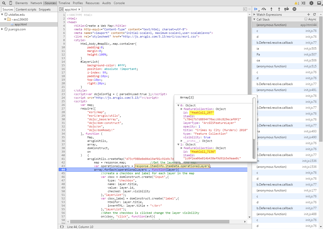

If you use the browser's developer tools (like this for Chrome), you'll first notice that you get the error
Uncaught TypeError: Cannot read property 'setVisibility' of undefined
The map isn't finding the correct map layer at line 60. You can set breakpoints in your code to see which layer id is being searched and the layer ids that the map contains. Setting one at line 43 shows the layers that are being returned.
However, when you examine the map's layers, it contains different ids.
I don't know why there's a discrepancy between the two items. Maybe Kelly Hutchins​ can explain this.
AravindSivasailam
Deactivated User
Hello Ken,
Thank you. I solved one part of the problem with the feature layer "883 stops" showing different IDs. This was because I erroneously published the point feature layer as points, lines, text and area layer. That's why there are 4 IDs.
I changed the layer to point alone and saved the map. Now, when I run the app again, I am able to toggle on/off the "883 stops" layer, but not the "crime by city" layer.

AravindSivasailam
Deactivated User
Hello Ken,
I solved the issue. It was a mistake on my part to not publish the layers I was using inside the web map. Once, I used both the published layers inside, it was very easy to be able to just modify the app.
The app works: Create a Web Map
