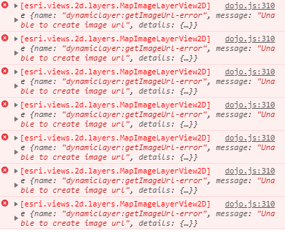

Something really strange is happening and I do not know why. When I create a new MapImageLayer and call for two sublayers whereas the visible value for both sublayers is 'true' I get an error.

So I just want to figure out what could be the cause of this issue. By the way I am using arcgis javascript 4.10

bobongubza
Robert, you are an arcgis wiz. Thank you, it worked.
Could you explain to me why it works in descending order but not in ascending order.

Before I mark as answered, something strange is still happening.

The same error i received as last time still occurs. Its kind of selective even if it is in descending order.
