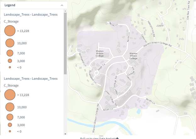

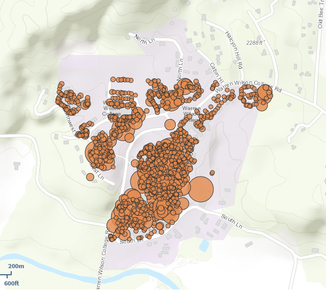

Below is the screen shot of the app:
 Point features are rendered if i refer Online API:
Point features are not rendered after deploying app.
