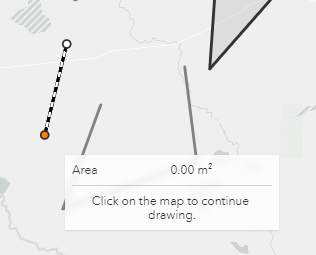

SumitZarkarCT
This is available now with 4.26
const sketchVM = new SketchViewModel({
view: view,
layer: graphicsLayer
//enable the tooltip options and turn on the helpMessage
sketchVM.tooltipOptions.enabled = true
sketchVM.tooltipOptions.visibleElements.helpMessage = true
