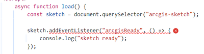

RyanDickinson1
Thank you Rene! I copied your pen and attempted using it in a vanilla single page app. However, the event listeners couldn't register (worked in your pen):

ReneRubalcava
Esri Frequent Contributor
That error looks like you don't have an arcgis-sketch element on the page. If you provide a repro per the doc, could tell better.

RyanDickinson1
I put the code into a pen and it functioned as expected. I have the standalone app hosted on a webserver and registered with Enterprise 11.1. Here is the link to the standalone in github.
ReneRubalcava
Ok, move the script tag with the load code to after the arcgis-map tag and before end of body tag.

You typically want script tags with JS as the last tag in the body so that it loads after contents of the html body load.
RyanDickinson1
Thank you very much Rene! That was it!
