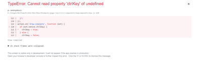

Valgenmap
Hi @RobertScheitlin__GISP
I am trying to include the solution in my ReactJS app but I'm getting error.
Can you help me in this.
Here is my code,
/* eslint-disable */

When I am trying to multi-select then I'm receiving this error at line 120 [native undefined].
 Thank you.
RyanPrice
I am seeing the same.
version 4.13, in the first example, is okay.
version 4.24 is NOT okay.  The draw-complete event is broken.  It does not have the native property.
