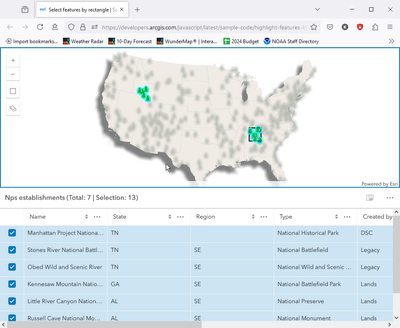

KenBuja
MVP Esteemed Contributor
Note that that sample isn't working correctly. Draw a rectangle to select features.
Clear the selection and draw another rectangle. Both the features in the current rectangle and the previously selected features are highlighted.

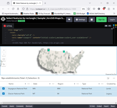

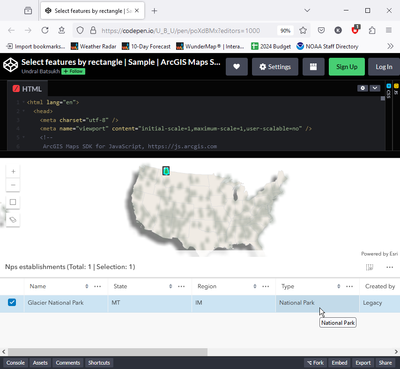

UndralBatsukh
Hi there,
Oh!!! Thank you for reporting the issue!
highlightIds and features variables are set as arrays at the top of the app so they keep getting features added to them. It needs to be instantiated in the callback so it's clean. I updated the sample and here is a codepen that works - https://codepen.io/U_B_U/pen/poXdBMx?editors=100
The sample should be updated on the SDK page next week.

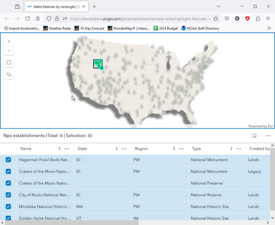

KenBuja
What's happening with the Total and Selection counts if you select multiple rectangles without clearing the selection? I've selected just single parks with two rectangles, but the selection says 3.
