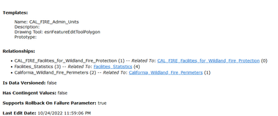

I am working with a non-hosted feature layer with a related table. The service is sitting on our REST endpoint, not on ArcGIS Online, because it contains data we consider sensitive. Because it is not hosted on AGOL, I am unable to use relationshipContent. Also, while I've been using the JavaScript API off and on for a while, I am still very much a beginner.
I ran across this sample earlier - PopupTemplate with promise | Sample Code | ArcGIS Maps SDK for JavaScript 4.26 | ArcGIS Developers. It meets a lot of my needs I believe, but I am unsure how to rework the code to pull from a related table. I believe I need to change the queryURL, but that may not even be doable.
Any guidance on reworking this code or suggestions on what I should consider instead?

AshleyPeters
I have, yes. We can't use that sample as a guide as the layer sits on our ArcGIS Server and not on ArcGIS Online.
I believe the closest I can get is actually using Query Related Records (Feature Service)—ArcGIS REST APIs | ArcGIS Developers. I have no experience with writing queries, so that's acting as another wall at the moment.

Do you have relationships set up in your service the way they are in the service used in that sample? If so, why wouldn't you be able to use your own services in a similar way?
AshleyPeters
I do.
But, per Esri, there is a limitation in ArcGIS Enterprise that doesn't allow it to work. It only works on hosted feature layers on AGOL. See the note here: RelationshipContent | API Reference | ArcGIS Maps SDK for JavaScript 4.26 | ArcGIS Developers
KenBuja
MVP Esteemed Contributor
Ah, thanks for that clarification.
