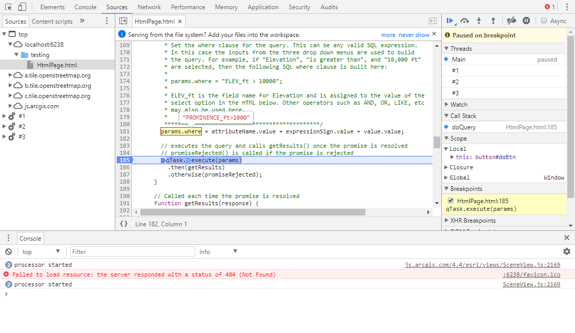

Here's an example using the Chrome debugging tools. I put a breakpoint at line 185 and clicked the Do Query button in the sample. The code halts before running the query and I can see (and copy) the whereclause when I hover the cursor over params.where line. Or you could add the line "console.log(query.where);" to write it to the console. This can then be used in the REST endpoint query to see if it works.
KirstenFrost_Andersen
I see.  Thank you.

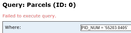

So here's what DT says with JS 3.16, which is working:
Here's what DT says with my code in JS 4.4, which is failing to execute:
Here is that where clause in the rest endpoint query:

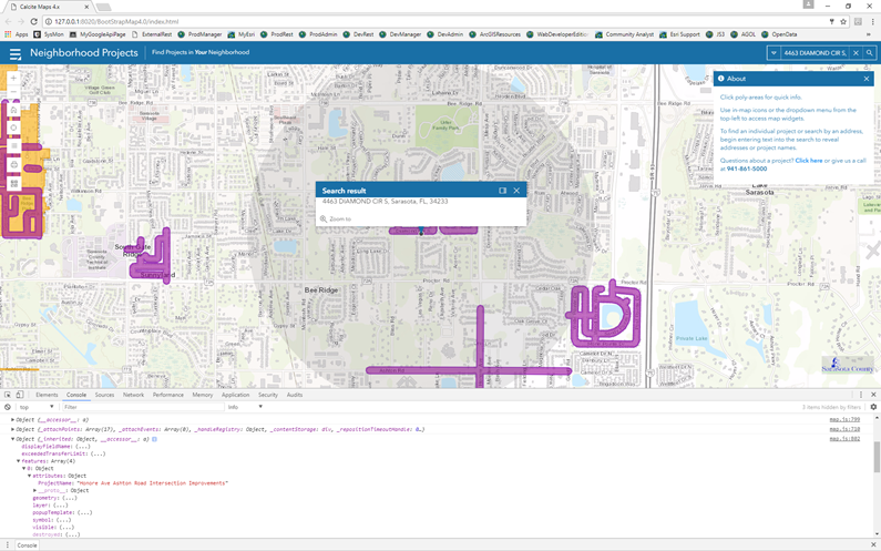

For 4.x, selectFeature method is not yet available for feature layer so the only option is to employ a queryFeatures method, something I'm still working on.  Here, we are using an address return point as an input to a buffer, then using the extent of the buffer to intersect and return features:
function showResults(evt) {
    app.activeView.graphics.clear;
    console.log(app.search.sources);
    if (app.search.sources.items[0].name == "Search by Address") {
       var qPoint = evt.results[0].results[0].feature.geometry;
       console.log(qPoint);
       buffer = geometryEngine.geodesicBuffer(qPoint, [1], 9035, true);
       var symbol = new SimpleFillSymbol({
          color: [100,100,100,0.15],
          style: "solid",
          outline: { // autocasts as esri/symbols/SimpleLineSymbol
             color: "white",
             width: 0
   graphicPoly = new Graphic({
       geometry: buffer,
       symbol: symbol,
    app.activeView.graphics.add(graphicPoly); //geometry
    var queryTran = new Query;
    queryTran.geometry = buffer;
    queryTran.spatialRelationship = "intersects";
    //queryTran.where = ObjectID > 0 //Don't really need this since we're using the spatial relationship
    var tranQuery = lyrMobBnds.queryFeatures(queryTran).then(function(tranResult) { //,    FeatureLayer.SELECTION_NEW);
    console.log(tranResult); //Does get features! Can't seem to set the attributes in the popup though
    if (tranResult && tranResult.features.length > 0) {
       app.activeView.popup.open({
       features: tranResult.features,
       location: qPoint//result.geometry.centroid
But I can't seem to figure out how to pass the results' return array and set that in my popup as opposed to the search result's return address.  I don't know if this will help you but maybe if there are more eyes on this some will have some ideas.

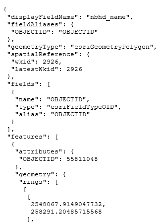

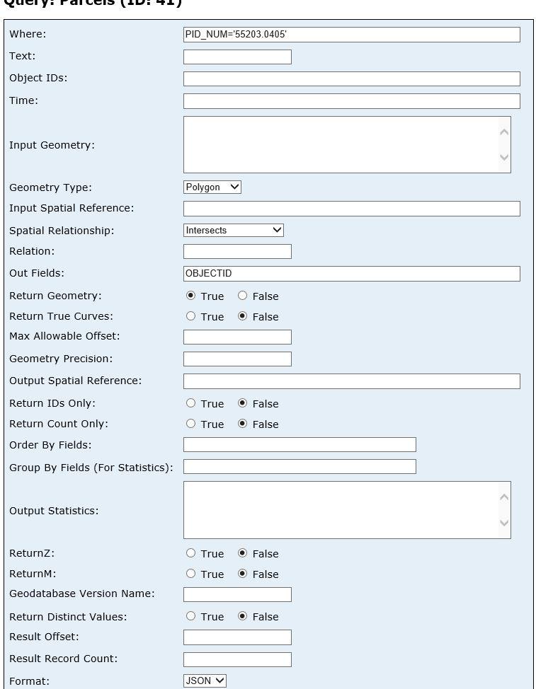

I am still trying every which way from Sunday to make this work and keep hitting walls.  I'm now able to run the query from the REST and here is the JSON result:

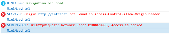

Here is the Developer Tools/F12 result that says nothing about my query, but still doesn't zoom to the parcel -- i get the same results when I throw in Ken's example for the promise:
I've tried FeatureLayer.createQuery() or FeatureLayer.queryFeatures() and get nowhere. I've tried converting to JS 3.16, 3.21 and 4.3; I couldn't get the map to even display with the first two and had troubles finding documentation for 4.3.  I'm back on 4.4 at the moment.  Any other suggestions?  I've been told I need to find a way to just select from the existing layer in the map rather than querying, but from all examples, it looks like that's what's being done here with the newer QueryTask library and the REST query is working which I'm trying to emulate in code.
