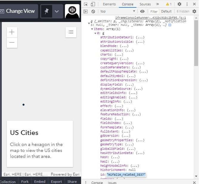

I am trying to make a query-related-features sample on a webmap with a point layer.
after getting the layer I try to queryObjectIds, the webmap returns a popup on the point I click so I know the screenpoint should intersect but the query returns "null".
When I console the layer for type it returns "feature".
And just to check that it doesn't have any restrictions for querying I queried the service on its REST page and got results.
I also turned on the objectId field inside the webmap on the layer.
        //find layer in webmap
        var layer
        webmap.when(function () {
          ///console.log(webmap.layers)
          layer = webmap.allLayers.find(function (layer) {
            return layer.id === "mifalim_related_3837";
          console.log(layer)
I am getting the Layer straight from the webmap and not creating a new feature layer by url like in the sample. Am I wrong treating it as a feature layer without creating it in code?
I even tried changing my query to a 5 mile radius on the off chance that the query looks for an exact xy when intersecting with a point.

litch
Yes, but the problem wasn't what I query but how,
The popup responds by graphic click so this is how I now get the OID without querying at all.
      view.on("click", function(evt) {
        // Search for graphics on click's position
        view.hitTest(evt.screenPoint)
          .then(function(response) {
            console.log(response.results)
        // isolate the correcet layer from graphics
            response.results.forEach(r => (console.log(r.graphic.layer.id)))
            var graphic = response.results.find(r => {
              return r.graphic.layer.id === "mifalim_related_3837";
        console.log(graphic.attributes.OBJECTID);

litch
The layer is inside a closed network, but it does load.
The  webmap I load is a test webmap containing  the layer and the relationship table just like the sample.
Is there anything I should check inside of it?
ChristianBischof
You could try to use the direct findLayerById Method of the WebMap class. Link below.
WebMap | ArcGIS API for JavaScript 4.18
litch
I redid the code with an online webmap that will work on codepen for you.
and I think i found the problem !
The intersect query doesn't care about the clicking on the point that opens the popup , adding 15km to this map returned an object-id and only if I was zoomed in enough.
Am i using the query function incorrectly?
Is there a way to get the id of the popup opened or symbology highlighted?
Can i listen to that event?
Also by global scope, do you  mean declare "var view" outside the require function?

ChristianBischof
Just a short answer to global scope, yes I mean outside of the require statement. Have you tried to use the queryFeatures Method instead of queryObjectIds? I assume at the end of the day you want the features to be displayed in the bottom left corner.
FeatureLayer | ArcGIS API for JavaScript 4.18
litch
