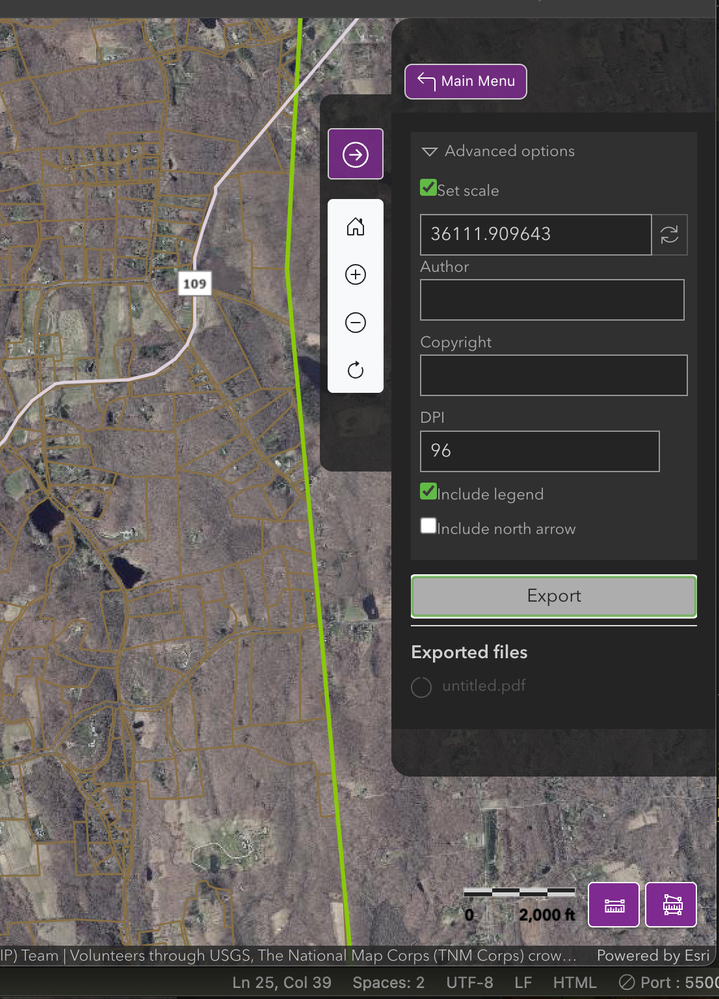

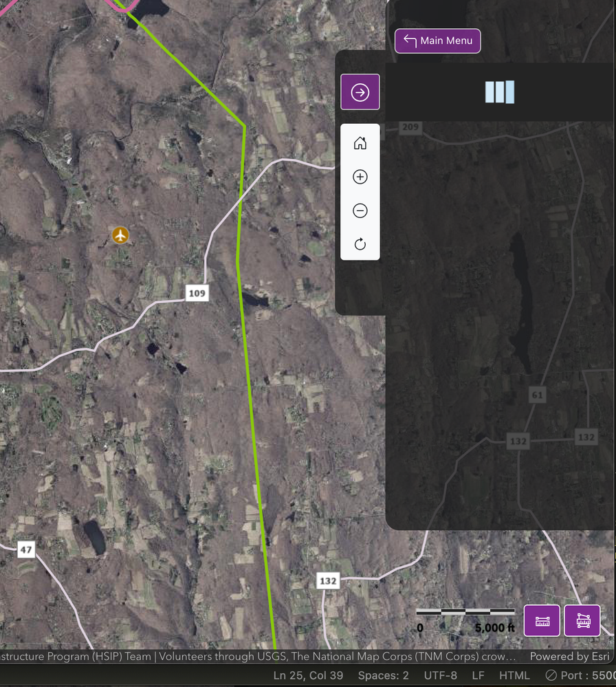

Hello,
I have been having issues for the past two weeks using the out of the box Print Widget in ArcGIS Javascript SDK 4.27. It seems to take up to a few mins to load the widget, then just as long to export. This widget has been great for me as my clients want to export in many different sizes, but the lagging has been a real sore point, as of late.
Any information or tips would be appreciated and a real time saver compared to developing a new print widget myself. Thanks!
Screenshot 2024-07-03 at 11.12.14 AM.pngScreenshot 2024-07-03 at 11.12.14 AM.pngScreenshot 2024-07-03 at 11.13.00 AM.pngScreenshot 2024-07-03 at 11.13.00 AM.png
