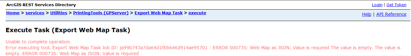

I get the error  when create more than 100 polygon
""Error executing tool.: ERROR 000735: Web Map as JSON: Value is required The value is empty. The value is empty. ERROR 000735: Web Map as JSON: Value is required"
the  value  is missing
the  size of  "Web Map as JSON" is limited?

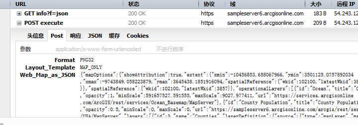

If the Web Map JSON is too large (> 2000 characters) the request must be a POST request.  See the comments by Jian Huang‌ in this post: https://community.esri.com/thread/67868#post355575
yanli
1.   I find with ff   the  print  request default   is  "post"  method  ,so I need't to change the request?
2. when i  fire the request directly at the REST endpoint? get  the error

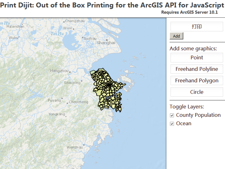

I modify  the  example online Print | ArcGIS API for JavaScript 3.17     , I create tht 136 polygons of city boundary with local json data  on map , it  still print error!I put the code into  github GitHub - yanliasdf789/Test1: arcgis for js print error with larte features
yanli
the position of polygons  are  in China
