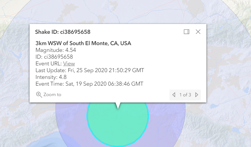

For instance I click the center polygon graphic; the pagination illustrates the correct 3 graphics to paginate through. As seen in the screenshot below:

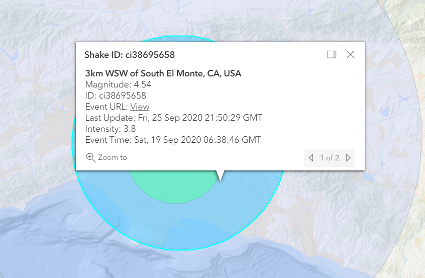

However, when I click the outer polygon graphic here; the pagination doesn't include the same 3; which should be to navigate inward - instead it doesn't include any... Screenshot below... then if I click the middle one, I can only paginate to 3, not one - again only including outward. So the problem is pagination can paginate displays correctly from inner to outward, but doesn't include any inner from outward.

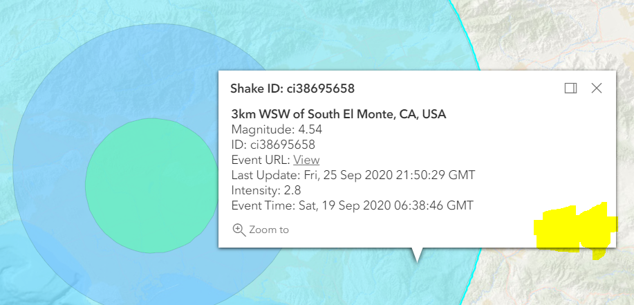

And the outmost outer; including nothing below as highlighted:

   Well that make perfect sense to me. When you click in the center you have 3 polygons that intersect the mouse click. When you click inside the second ring from the middle you have 2 polygons that intersect the mouse click and when you click inside the outer ring you only have one polygon that intersects the mouse click.
