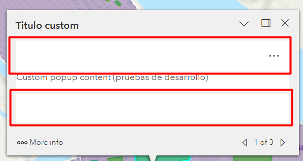

Hello everyone!
My problem is that, a footer and a header appear within the content of my popupTemplate, they began to appear when I integrated a custom action to the popup, but I am not sure if that is the cause, or perhaps the version change and the fact that the popup now contains calcite components. The fact is that this problem is not present in the map viewer, only in the app.

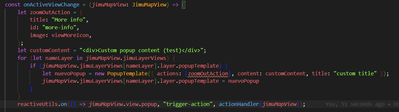

MatiasTonelli1
Hi @LaurenBoyd thanks for the answer, I'm currently using these versions:
But are you sure that's the reason? Because I tried to leave the popup as default as possible, without any type of calcite component, and the header and footer also appear. Look, I tried this:
