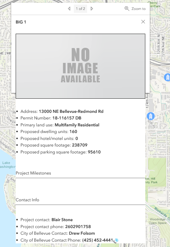

Hi,
I'm finding there is a bug or several bugs with IE brower when configuring popups to use the docking positions (using 4.10). I created a simple demo app, and specified created the mapView like this:

This causes the popup to default to the specified dock position. It works fine in chrome and other browsers, but in IE, most of the dock positions cause a bug. Below is the screenshot for bottom-center:
Other positions have similar issues, including content overflowing popup container, and for bottom dock positions, the position is shifted to the right (bottom-center and bottom-right).
I have been messing around with css to fix the issue but not much luck so far. I'm attaching a word doc with images of the different doc positions....
I'll report this as a bug, but if anyone has thoughts about how to work-around this in the meantime, great. I'd prefer for my app to specify bottom-center.

Robert, thanks for the reply. You are using Internet Explorer to preview this right? I'm still seeing buggieness with the sample you provided. I added some more content to the popup but changed nothing else. Here are screenshots of what I'm seeing:
top-center and top-right work as expected
top-center - positioned correctly, but does not handle overflowing content - no scrollbar
bottom-center - same as top, but also shifted to right
bottom-right - shifted almost entirely off the map to the right
bottom-left - positioned correct, but no scrollbar
this is with IE 11.
