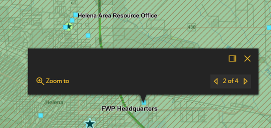

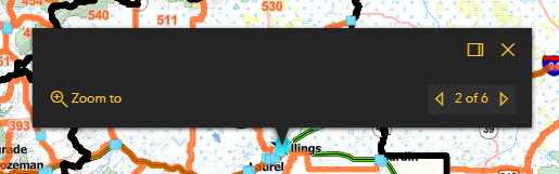

Edit: Here's what the behavior looks like when it happens:

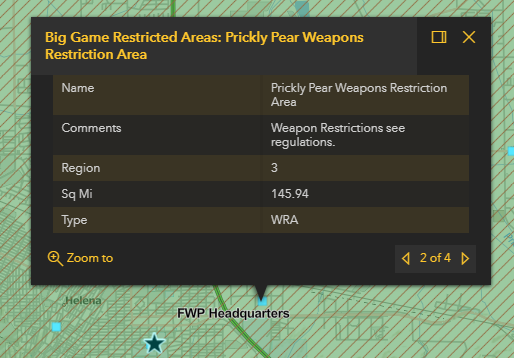

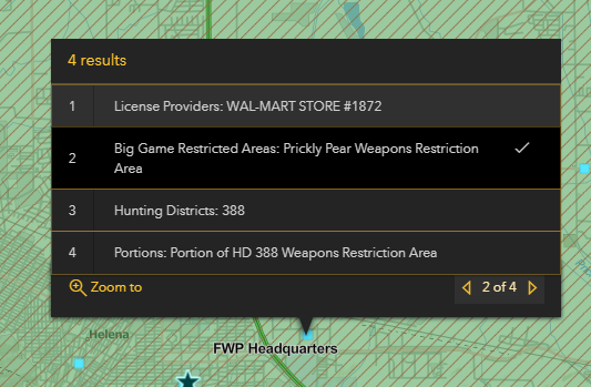

I've found a new wrinkle in this behavior. If I get the empty popups issue, if I then use the 'x of n' selector the popups will then fully populate:
After clicking the 'x of n' button then all popups appear to be correctly populated, even if I don't actually select a result but instead close the 'x of n' box to close it back to the original first popup. Does this suggest some sort of async issue? I also just noticed that the list of popups shown after clicking 'x of n' sometimes shows n popups, and sometimes shows n-1 popups. I'm having a hard time seeing a consistent pattern here.
