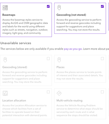

According to this doc, you can only access the places service if you have an ArcGIS Developer account. ArcGIS Online accounts are not supported.
You also need to enable to the Places service for your api key. To do it, edit your API key and enable Places service. Then try our the places tutorial
