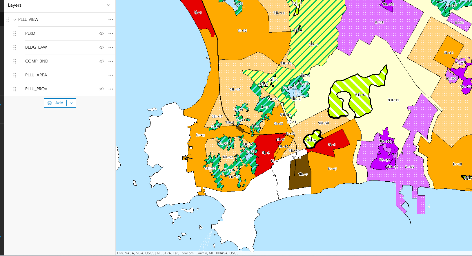

This is the correct displayed example when I add whole map service as MapImageLayer. PictureFillSymbol with striped or dotted can display correctedly

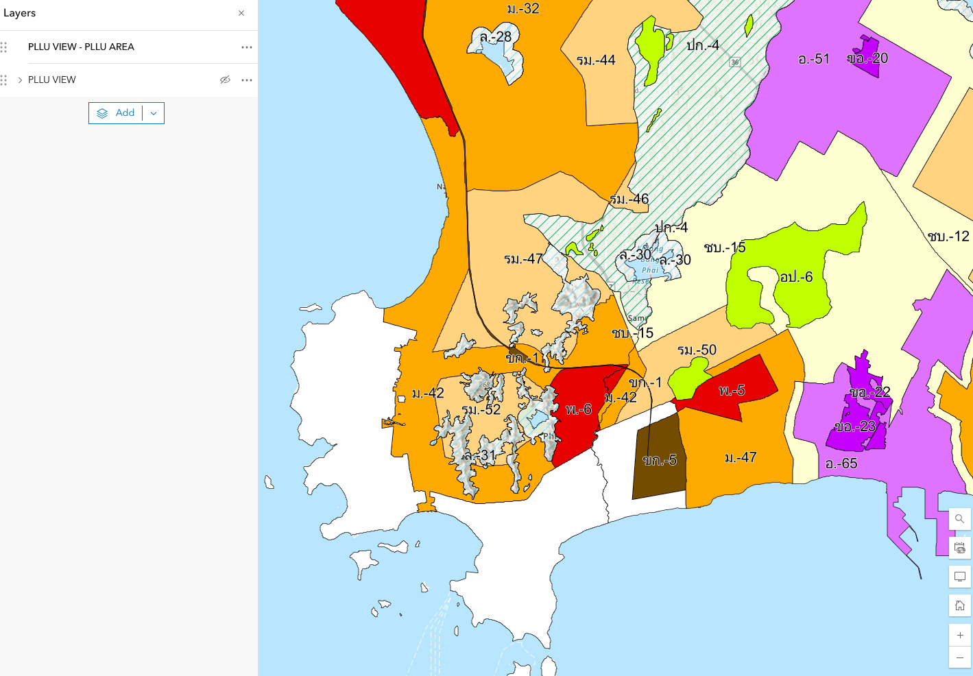

However, when I add only sublayer as FeatureLayer , the polygon with PictureFillSymbol with striped or dotted pattern doesn't appear correctly
Do I have to set any properties to make FeatureLayer display correctly? Please help me resolved this.

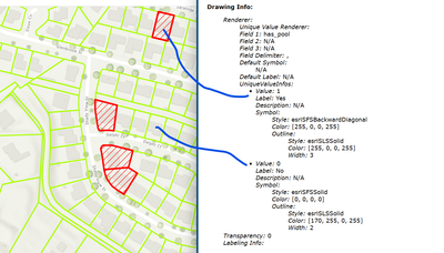

If you go to the URL of the sublayer, does it have "Drawing Info" defined? Maybe it's only defined in the parent layer.
I found a sublayer in esri samples: https://sampleserver6.arcgisonline.com/arcgis/rest/services/PoolPermits/MapServer/0 If I add it to a map, it's symbols match the Drawing Info.

I checked a sublayer in my map services. There are drawing info that has a diagonal (striped) or dotted pattern
