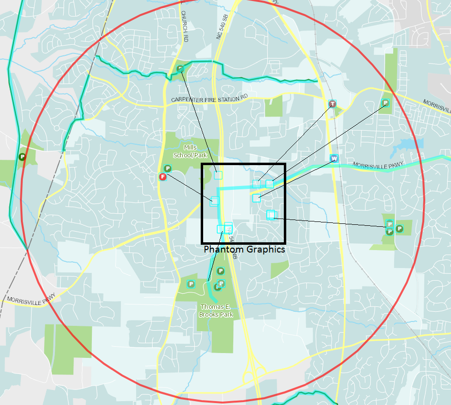

Greetings,
 This is definitely strange. I am selecting features from a point, a polyline and a polygon featurelayer by distance from a point. I'm creating a graphics layer for each featuretype and highlighting the graphics in the map. All feature types but the points display properly. The points however, maintain a set of phantom graphics that persist at the zoomscale at which they were created. So when you zoom in, there appear to be a second set of point graphics with the same geometry relationship but at the scale at which the graphics layer was first drawn.
The interesting this is that if I add the graphics to the graphicsLayer and do not refresh programmatically, then when the graphics layer redraws when the zoom scale is changed there is no issue. However, if I redraw the graphics layer programmatically then the issue presents.
I've dug in a little to try to debug this situation. I created a mouseover event on the graphics in the graphicsLayer but the phantom graphics do not respond. The length of the graphics in the graphics layer does not include the phantom graphics either.
Has anyone ever seen this? Also, what method does a zoom change call on the graphicsLayer? I had assumed that redraw was called on the graphicsLayer but redraw also causes the issue to present.
Please see the image that I have included. The 'Phantom Graphics' are outlined in black. I have zoomed in and drawn black lines to the points that these phantom graphics correspond with at the initial scale that graphics layer was drawn at.
Any information or tips will be greatly appreciated.
Tyler

I've run into a similar issue that may or may not be related (in my case I didn't notice any relation to zoom scale).  I was creating a graphics layer, adding graphics to it, clearing it, and adding more graphics all within a very small timespan.  The result was that some graphics would get "stuck" nondeterministically (from my perspective anyway) i.e. they'd be visible in the view but were nowhere to be found in any graphics collection, and calling graphicsLayer.clear() did nothing.
I fixed this by ensuring that the graphics were not cleared and added within the same fraction of a second (about 100 ms).
The thing to do is probably to try to reproduce this in a sandbox:
1.  You're using the 4.4 API, correct?  Map View or Scene View?
2.  What method are you using to search for nearest graphics?
3.  What method are you using to highlight graphics?
4.  The graphics layer in question holds the highlights, correct?
Any sample code or pseudocode would also be helpful to replicate this.

Here's my attempt to reproduce: JS Bin - Collaborative JavaScript Debugging - click map to perform a search.  Everything seems to be working normally.  I'm only doing this for a single point feature service though.
I would try calling graphicsLayer.add() for each graphic in the returned featureSet rather than setting the .graphics property equal to featureSet.features.  I couldn't get the "highlight" graphics to show up at all, even with a redraw, using the method you posted.

Thomas Solow, I created a HTML/ESRI JavaScript API 3.21 that I created for ESRI support. I thought I'd share it here too. To reproduce the 'phantom graphic' issue follow these steps:
1. Preview the attached html file.
2. Click on the map near some trees to reverse geocode a point.
3. Click on the 'Buffer & Find nearby trees' button in the resultant popup window to create a graphics layer that shows the selection set of trees within 0.1 miles of your click point.
4. With the light blue selection set added to the map as a graphics layer, zoom in one step and the 'phantom-graphics' will appear.
