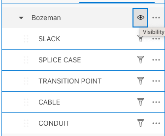

On a group layer like below
            new GroupLayer({
              title: 'Example',
              visibilityMode: "independent",
              layers: featureLayers
In the follow screen shot if a user checks the eye of the whole group layer  to hide then go to a sublayer and check that to show nothing happens our users are find this confusing
version is 4.29 of the SDK

Hi @MikeBehan ,
I'm sorry to hear that your users are finding it confusing.  I could be misunderstanding the question, but the `independent` visibility mode is designed to work in the way described.  The parent group layer and it's children's visibility are independent from each other.  Perhaps `inherited` would be a better choice for your use case.  This would match the visibility of the child layers to that of it's parent group layer, but with the disadvantage of not being able to control the individual child layer's visibility outside of that of the group layer.
https://developers.arcgis.com/javascript/latest/api-reference/esri-layers-GroupLayer.html#visibility...
Sage_Wall
Hi @MikeBehan , If you do want to enable this kind of behavior where the child layer set's the parent to visible when it is visible you could likely add something like this in the listItemCreatedFunction
https://codepen.io/sagewall/pen/rNELgJa

JohnGrayson
Esri Alum
Another option I've done previously, and if you're controlling the entire UX, is to disable the ability of the child layers to change their own visibility if the parent layer is not visible.
