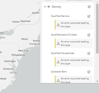

I have multiple feature layers being hosted on my account (share setting is set to owner).  I cannot see any of the layers. I have implemented the esriConfig.apikey into my code but I'm not able to access the layers

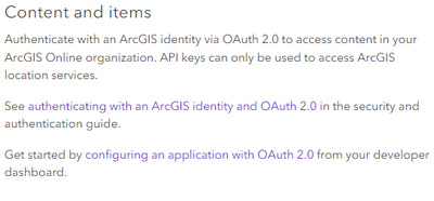

Hi @LaurenBoyd when I got to Content and Items its asking me to create an application with OAuth2.0. I created the application but I'm not sure what to do next
