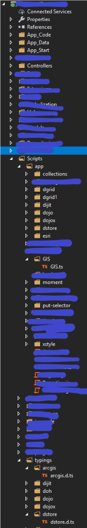

Hopefully this helps someone else but here's how we setup ESRI javascript API within our MVC 5 that is also written in typescript and where we are hosting the ESRI files

we downloaded the argis javascript API and dumped the contents into Scripts/app
we stored our typescript typings in Scripts/typings; You have to go and get the typings for dojo, digit, dstore, etc. The typings for arcgis are here
