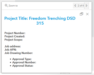

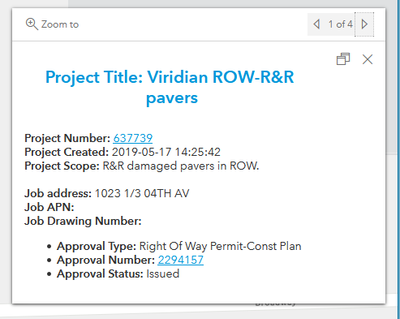

I am having a display issue with stacked pop-ups.  My first pop-up displays correct.  However if I use the arrow to go to the next pop-up it does not display.
Thank you for the help

RyanBohan
Great catch Jeff, that is just sloppy on my end.
I figured it out! Just had to add
outFields: ["*"],  //fixed now shows multiple points
