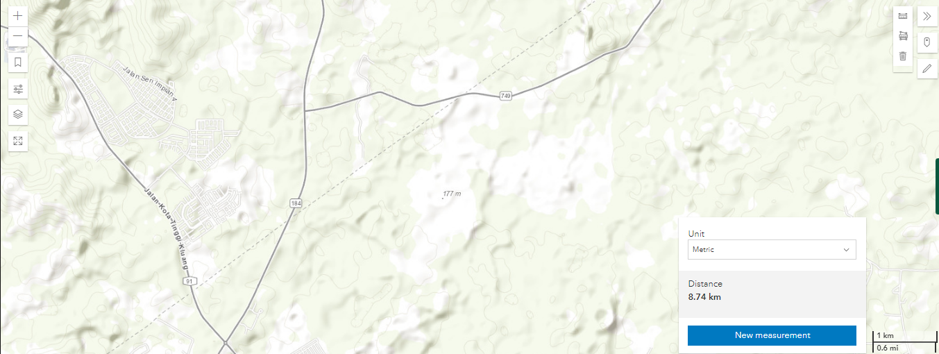

Migrated my project from esri-load module to arcgiscore (4.24.7), and managing assets locally(managing-assets-locally ) in ReactJS. Measurement , Sketch and SketchViewMode widgets which are working fine in esri-load module , after migrating to arcgiscore graphics not showing up while drawing through these widgets and getting this below error while map is loading.
Below screenshot while drawing through measurement widget

Hi @AndyGup , just confirm you I am not hosted the ArcGIS API for JavaScript instead of that  managing the assets  locally through help of below URL.
https://developers.arcgis.com/javascript/latest/es-modules/#managing-assets-locally
After following the steps in above URL, under public folder of my project components and esri subfolders are created successfully.
As I mentioned earlier in my query esri sketch, sketch view model and measurement widget graphics are not showing up while using "@arcgis/core": "^4.24.7".
AndyGup
Hi @AbdulSamim  these types of errors are typically related to project configuration, and not a bug in the ArcGIS JS API. Please provide a link to a simple github repository that reproduces the issue.
