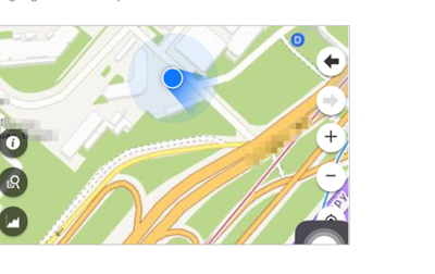

Is it possible to show location accuracy in map like location headsup while rotating mobile as it is shown in below image?
Please provide the solution to get this 'blue-cone' in arcgis map.

This was kind of fun to do. Geolocation coordinates return an accuracy in meters.
https://developer.mozilla.org/en-US/docs/Web/API/GeolocationCoordinates/accuracy
You can use this value with the view resolution to figure out the size of the marker you want to display.
https://developers.arcgis.com/javascript/latest/api-reference/esri-views-View.html#resolution
I think I did this math right, I'm sure someone will correct if I didn't.

The Geolocation API also returns a heading you can use to rotate you symbol, which would be simplest, or you could calculate how to draw a short line in that heading. I'll leave that up to you.
https://developer.mozilla.org/en-US/docs/Web/API/GeolocationCoordinates/heading
