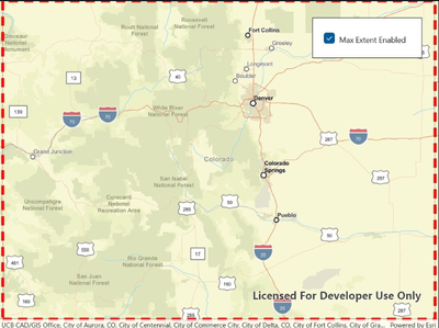

UndralBatsukh
Yes you can set the geometry constraint on the MapView. You can see the behavior in this app: https://codepen.io/U_B_U/pen/zYyvWZQ?editors=100
