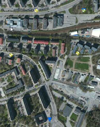

not using dynamic layer...as you can see i'm getting no halo.. and placement is always top right regardless.
its barely even usable in its current state in my opinion. i know there is probably a 'css' workaround for the halo.. but i'd prefer a nicer solution

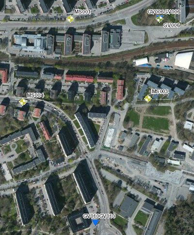

using Dynamic service layer (static testing).. labels seem fine.
another quirk is you notice the roughness of the symbol when using Dynamic Service Layer...,
compared to the manual specification of the symbol in the featureLayer.. odd..
