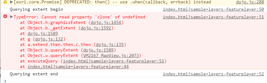

I'm trying to queryExtent with a layer view. Instead of getting the extent, I got a strange exception:
The code is very simple:
function executeQuery(lyrView) {
    console.log("Querying extent begin");
    lyrView.queryExtent()
        .then(function(result){ console.log(result); })
        .catch(function(e){ console.error(e); });
    console.log("Querying extent end");
Here is an running example: FeatureLayer LayerView QueryExtent
It seems that this issue only happenes on point-based feature layers. lyrView.queryExtent works as expected on polygon feature layers. Maybe it's a bug?

Hi Qi,
that is indeed a bug on our side. We'll fix this for 4.8. Can you tell me what you're trying to achieve, maybe we can suggest a workaround until then.
