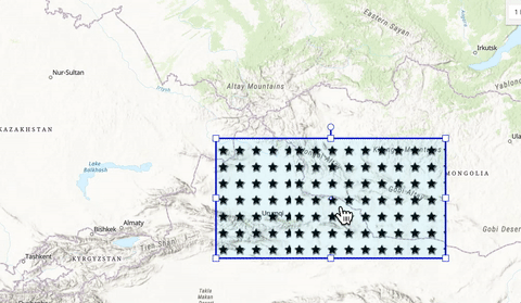

Check out this test app for how it should work. Create a rectangle and you should see picturefillsymbol scaling, resizing and rotating as expected.

Running your example, the picturefillsymbol does not stretch to fill the sketched geometry, and does not scale or rotate as the sketch graphic is edited.  It always says the same rotation and scale, and repeats to fill the extent of the geometry.

Can you please clarify the behavior you are describing?  Here is what I see.

Yes I see what you see.  Your background image of a single black star is not stretching to fill the the extent of the sketched graphic, is not rotating as as the sketched graphic is rotated, and does not scale as the sketched graphic is scaled.

It is working as designed.
It wont fill the extent of the polygon. It will fill the shape of the polygon.
Rotation is working as designed.  Stars wont scale (wont get smaller or bigger). The fillSymbol will always fill the polygon you are creating.
