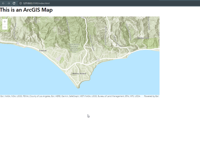

Jordi-Monk-Developer
Hello, the code below works for me. Substitute your API KEY appropriately.
<html>
  <head>
    <meta charset="utf-8" />
    <meta
      name="viewport"
      content="initial-scale=1, maximum-scale=1, user-scalable=no"
    <title>ArcGIS API for JavaScript Tutorials: Display a map</title>
    <style>
      html,
      body,
      #viewDiv {
        padding: 0;
        margin: 0;
        height: 100%;
        width: 100%;
    </style>
    <link
      rel="stylesheet"
      href="https://js.arcgis.com/4.22/esri/themes/light/main.css"
  </head>
  <body>
    <h1>This is an ArcGIS Map</h1>
    <script src="https://js.arcgis.com/4.22/"></script>
    <script>
      require(["esri/config", "esri/Map", "esri/views/MapView"], function (
        esriConfig,
        Map,
        MapView
        esriConfig.apiKey =
          "YOUR_API_KEY";
        const map = new Map({
          basemap: "arcgis-topographic", // Basemap layer service
        const view = new MapView({
          map: map,
          center: [-118.805, 34.027], // Longitude, latitude
          zoom: 13, // Zoom level
          container: "viewDiv", // Div element
    </script>
    <div style="height: 50%; width: 50%" id="viewDiv"></div>
  </body>
</html>
Which should render like:
Is that what you wanted?
