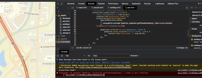

AmitKahn1
Thank you @kerenc for your assistance.
Code fails during runtime:
projection.load()
esri.html?_ijt=b7g5ecd5goqr8hnarkbpa2atn5:66 Uncaught (in promise) TypeError: projection.getTransformations(...).then is not a function
at esri.html?_ijt=b7g5ecd5goqr8hnarkbpa2atn5:66
Can you please advise how to fix?
Also, I am not fixed with specific method for getting map projection. Also tried GeometryService that failed since require("esri/tasks/GeometryService") gives Error: undefinedModule ... however here is the code:

at getProjection (esri.html?_ijt=b7g5ecd5goqr8hnarkbpa2atn5:59)
@kerenc As you could see I've tried to solve the problem from different angels, so far no success.
I thought that the question of getting the boudries coordinates (Lat, Lon)  of a map view should be fundamental. I hoped to find a straightforward way to get it.
Thanks for your kind help, any solution that can provide the mapView Lon/Lat visible area projection is most Wellcome. Looking forward your respone.
Best,
Gabriel
kerenc
You really do not need all those lines to get the visible area, you can watch the view's extent and get it.
Esri's help samples has is a nice sample that demonstrates it: https://developers.arcgis.com/javascript/latest/sample-code/watch-for-changes/index.html
In order to get the spatial reference just read view.extent.spatialReference
Regarding your code fix, I apologize, At first glance, I thought that it failed because the method returns a promise and after reading the api reference I realized you were missing the call to projections.load().
I forgot to change it back.
Here is the fixed code:

kerenc
BTW , in order to change the extent to WGS84 it is much easier to use webMercatorUtils  and there's no need to load the projections.
AmitKahn1
Dear @kerenc ,
Thank you so much for the solution. For the sake of other who straggle the exact same, here is the complete code below.
Best,
Gabriel
