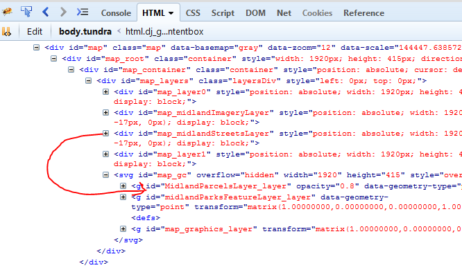

For the record, I'm not a GIS guy. I'm a web developer working for a GIS company. So one thing I've noticed in terms of the HTML that is generated is that when I  add multiple tile layers, they are created inside their own DIV containers which makes for easy reordering of Tile Layers. Feature layers on the other hand all get lumped into one SVG object. This makes it IMPOSSIBLE to shuffle a tile layer between two feature layers as you can't exactly put a 'div' element between two 'g' elements within the SVG element.
So, am I just missing something? Does anyone know of a work around for this? If I could have more than one "Graphics layer" container, and by that I mean more than one SVG container to assign feature layers to, I would at least have some way to set classes, add z-indexes, or preferably use the API methods for reordering layers. To me this seems like a pretty basic idea, which makes me thing that I MUST be missing something.

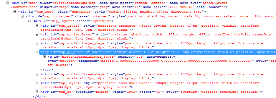

Well, since there doesn't appear to be a way to do what I need from the API, so I just decided to hijack the layer I wanted out of the DOM. I use jQuery all the time, so that is what this is written in. Basically, I made an empty copy of the '#map_gc' SVG element container and placed it before the layer I wanted to put it under. I then copied it's attributes (overflow, hight, width, and style). Finally, I used the append command (similar to appendChild) to remove the graphics layer(which was the feature layer of parcels) I wanted and add it to the new SVG container. Not included in this example but on my TO-DO list is to set an event handler to re-copy the attributes when the map resizes.
Note that this is written to only run once. I think I will have to put some of this code into a function if the feature layer is to be removed from and added back to the map.

This appears to be working. I can pan, zoom, click on parcels to open popups and everything acts as one would hope. Hopefully this helps others

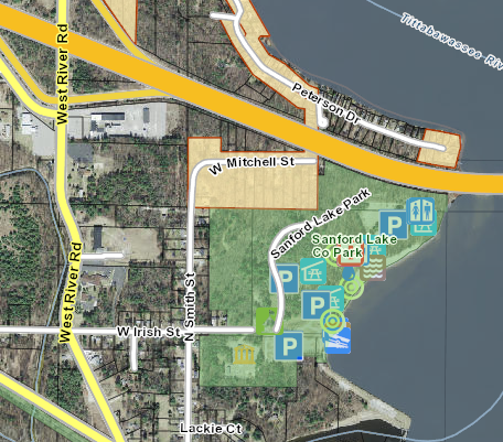

This first screen shot is of an implementation I put together in Leaflet. Everything is working as it should in this screen shot. (For the record, I had to 'hack' at this a bit to make it work like this, but it works great)
Another screen shot of the Leaflet implementation, zoomed out one more level where the park has a transparent green overlay:

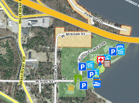

Now I'll show the screen shots of the esri JS API version. This first one is how the layers stack normally.Capture4.PNG
And zoomed out one more level so you can see the park overlay that appears (more on this later):

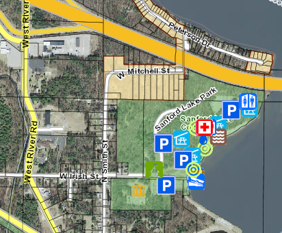

So, to get around this, the only thing I could think of was to set z-indexes of layers in CSS and assign 'pointer-events: none;' to the transparent tile layer so users can click through it. While this worked for me in Leaflet, it is obviously not how ESRI intended things to be (and by that I mean having to hack things to work correctly). Notice the buildings are on top of some of the markers. This is less than ideal.
Zoom out one more level, and the park overlay makes things even uglier:
Currently, this is the only set of marker icons we have on any our maps, so the idea of redrawing all of those layers (streets, buildings, overlays, etc in multiple counties in our state) as a Feature layer makes my employer cringe in terms of time and effort.
