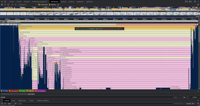

Hi all,
i  have a bad sceneView performance when i load a scene server in my project (let's call it project A ), the model rendered slowly and when i tried to adjust the tilt or zoom, all operations tend to be jagged.
the image below shows the slowest frame has taken more than 450ms to render. (record from chrome performance tool )

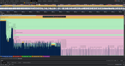

then i created a simplified project (let's call it project B ) and load exactly the same scene server and same basemap; and everything went smoothly fast.
each frame takes less than 120ms

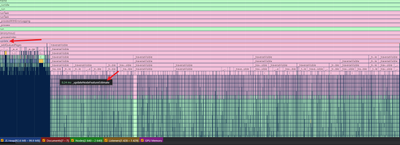

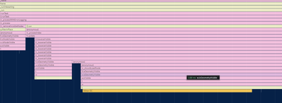

i compared those two and discovered the difference occurred at function *update*, in which project A repeatedly called the function  *_updateNodeFeatureEstimate*
 *_updateNodeFeatureEstimate*  - * _getSphereScale *
while the project B has a lighter function stack in here.
