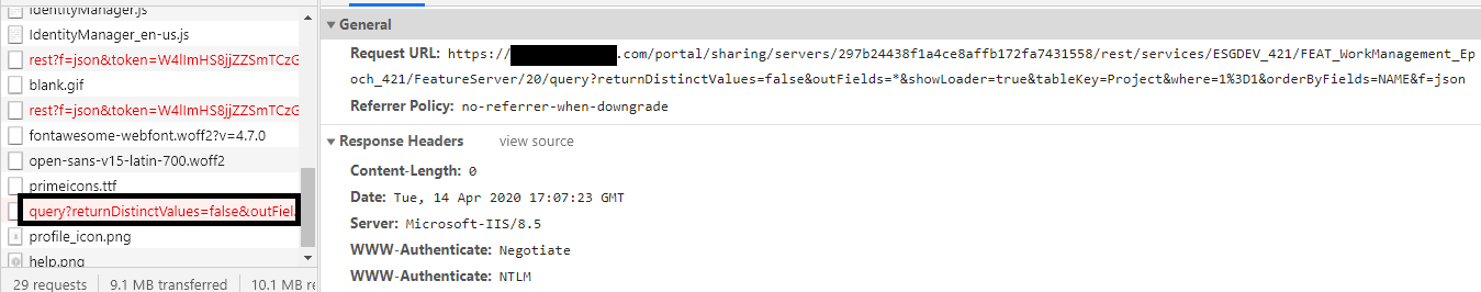

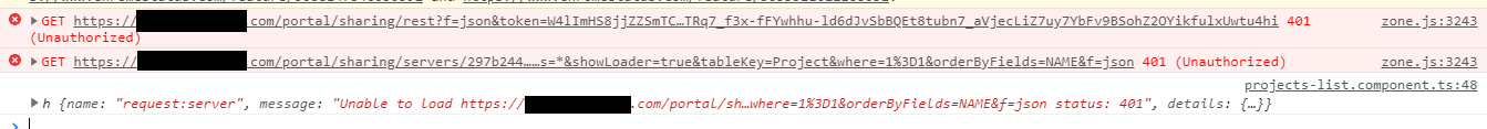

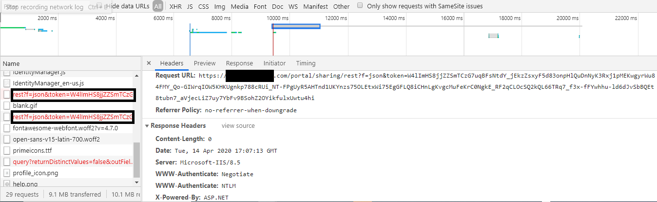

I tried passing the token that I am getting after successful login into headers like X-Esri-Authorization header, Authorization header and as query parameter token to subsequent requests No Success. Screenshots for error and network details.
What happening here in our app is we have guards for every URL to check the sign-in status. After a successful login, the user will be redirected to the home page when his sign-in status is checked. The first two error calls are from check sign-in status which has token in it and the third error call is to the feature service.
Not sure if I have to implement anything that is specific to handle IWA in the code for the login. Any help would be appreciated.
