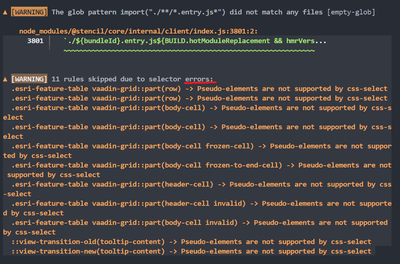

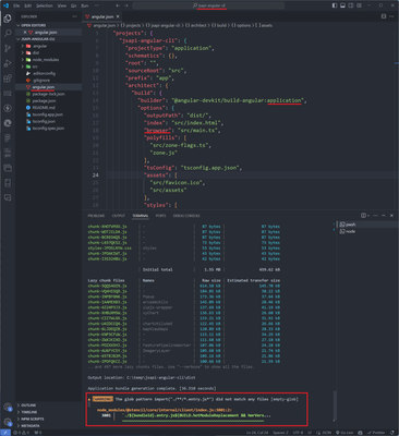

I'm developing Map Website using ArcGIS Maps SDK for JavaScript and Calcite Component with Angular. I got issue with "ng build". "ng serve" works well.
▲ [WARNING] The glob pattern import("./**/*.entry.js*") did not match any files [empty-glob]
node_modules/@stencil/core/internal/client/index.js:3801:2:
3801 │ `./${bundleId}.entry.js${BUILD.hotModuleReplacement && hmrVers...

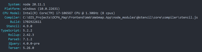

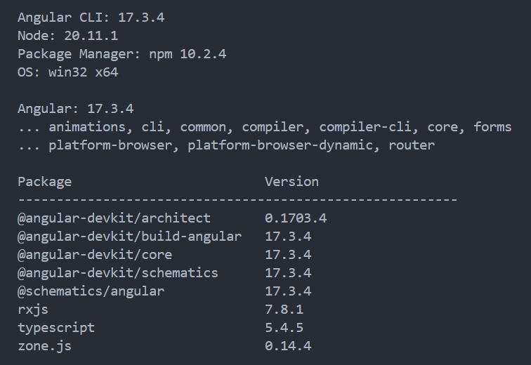

"ng v" gives me:

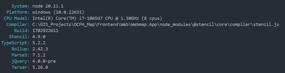

"npx stencil info" gives me:

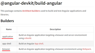

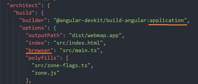

I figured out that the issue is caused by building an Angular application targeting a browser and server environment using esbuild, instead of using Webpack. So we have to use webpack?
https://www.npmjs.com/package/@angular-devkit/build-angular

I downloaded the code:
https://github.com/Esri/jsapi-resources/tree/main/esm-samples/jsapi-angular-cli

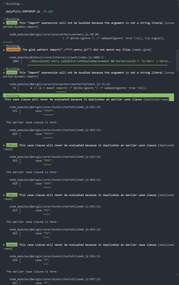

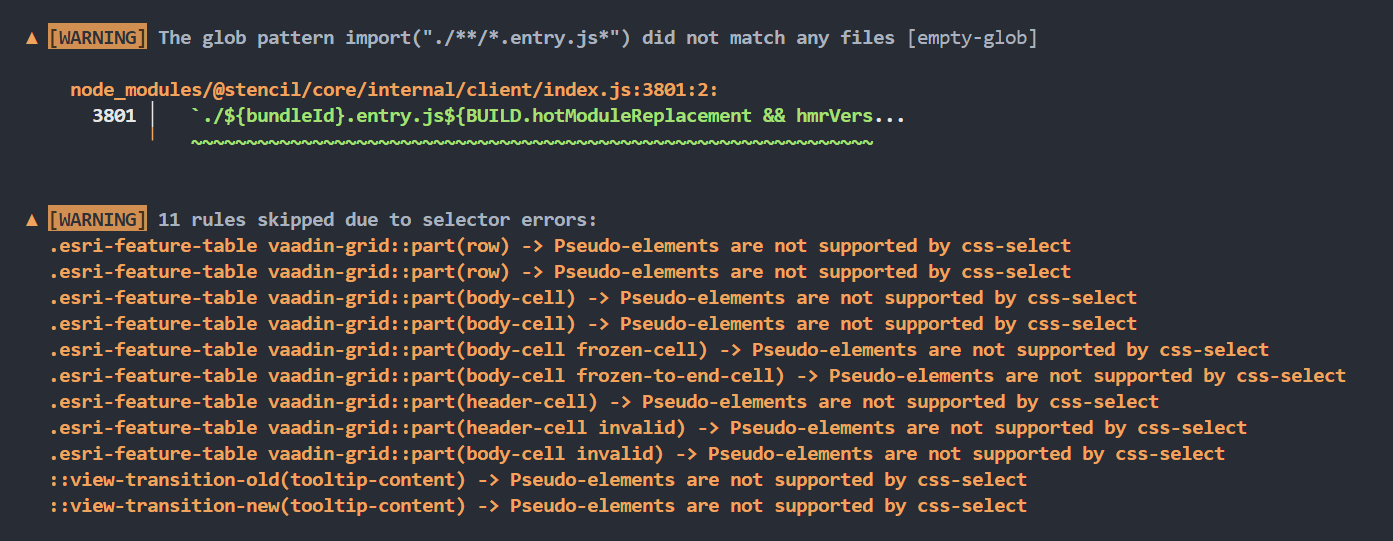

and change the builder to esbuild, then I got:
By the way, how/where can I provide a repro app?

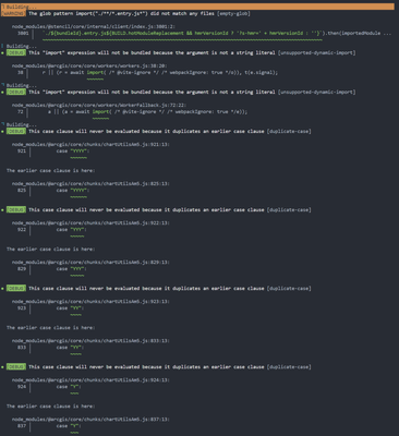

More details:
ng build --verbose

Are the selector errors OK?
11 rules skipped due to selector errors:
