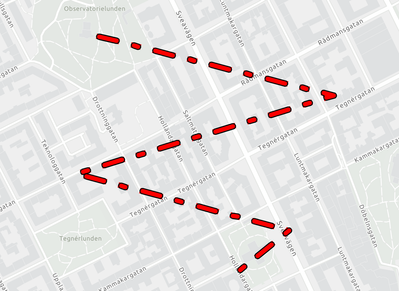

Can a symbol like the one below be made? It is a line symbol, with outline, dashed.
I have played with CIMGeometricEffectDashes but it does not look good 🙂
https://codepen.io/viktor-safar-geodata/pen/abXWBVZ
AnneFitz
The order that you apply the effects makes a difference -- so try doing dashes first, then the buffer effect.

AnneFitz

ViktorSafar
If anyone is looking for this, I have updated the code pen
