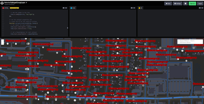

If we change :
  item.layer.labelsVisible = true;
the labels are shown as below:
 ArcGIS users as us intend to learn what the following expression exactly means from ArcGIS team actually.
        labelExpression: "$feature.assetgroup"
The sample code just confused me.

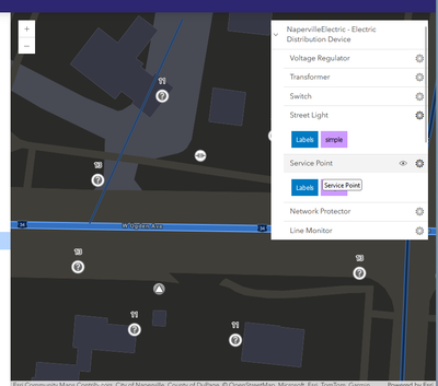

I think what the sample is doing is showing how to do different things with the layers. If you click the gear icon on a layer, the "Labels" button will show or hide the labels and the "unique" button will symbolize the data with a simple renderer or a unique-value renderer.

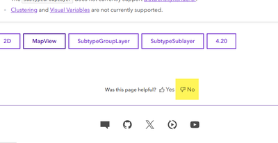

If you find errors in the sample code, it's more helpful to give feedback directly to Esri about this. To do that, scroll to the bottom of the page and click the thumbs down icon. This will bring up a dialog to send a message to the team.
