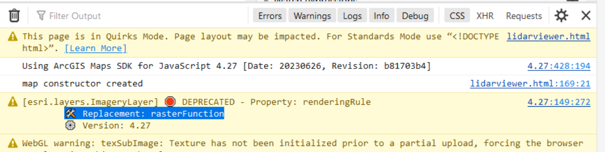

I updated my app to v. 4.27 from 4.24 and now I'm getting this warning. I changed the property from ImageryLayer to rasterFunction, however that caused the imagery not to draw. Any help appreciated.

After creating a case, we found out it was not in the javascript. Rather, one (or all) of the layers in the webmap was causing the warning as it was rendering. I had a hand full of ArcGIS server web services (orthos and lidar) in the webmap. After creating a new webmap and adding those layers with the exact same properties, styles and effects the warning was no longer there. If anything, it's a work-around.
