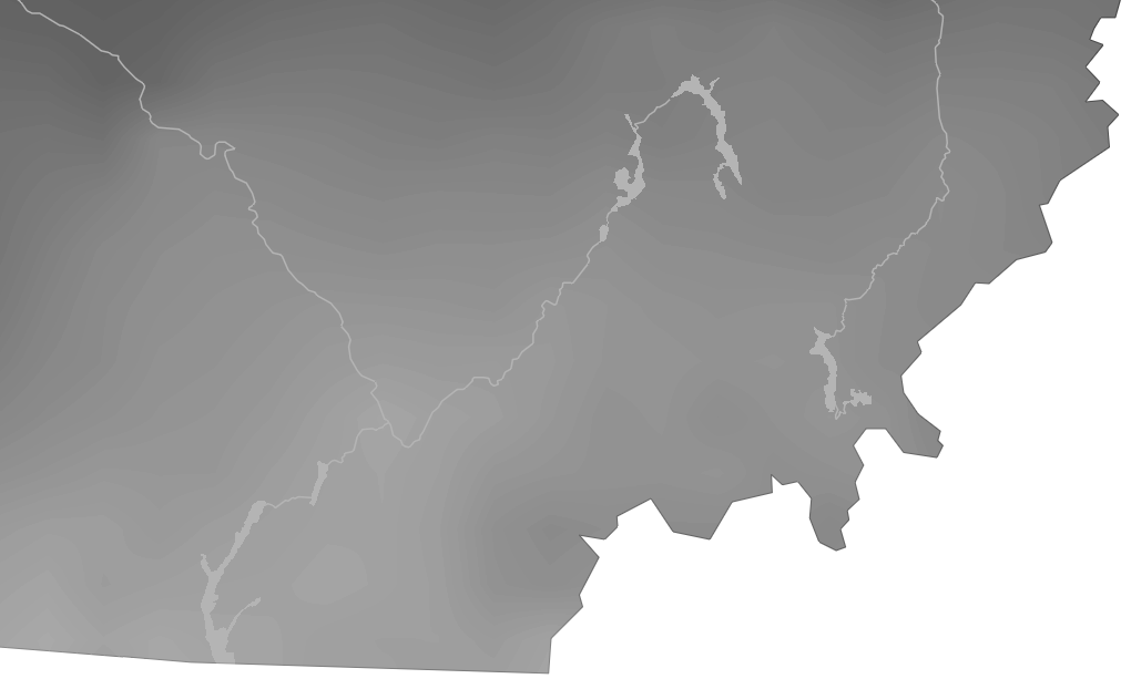

Hello,
My javascript map properly display an imageryLayer coming from an image server:
As you can see, the layer in displayed with bilinear interpoaltion as asked in my code:

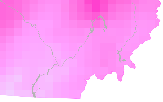

Now if I add a renderer to the imagery layer, the dsplayed image is no longer interpolated:
You can see all the individual pixels. It seems that the interpolation properties is now ignored despite what I wrote in my code:
let layerTMOY_QUOT = new ImageryLayer({
    url: URL_TMOY_QUOT,
    renderer: rendererTemperature,
    interpolation: "bilinear",
How can I use both a renderer and interpolation of the displayed pixels?

Nicolas_
Ok I found a solution. Forcing the format of the ImageryLayer to be "lerc" show the images as interpolated again:
    url: URL_TMOY_QUOT,
    format: "lerc",
